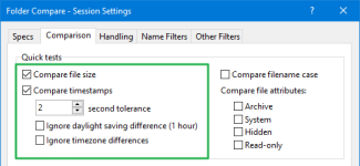

Rather writing a script (and I love writing scripts) I would do it the easy way with Beyond Compare. You can use the trial version, but it's well worth buying the standard edition. I use it almost every day.
  1. Open Beyond Compare.
  2. Select the 2 folders to compare.
  3. Click On "Session > Session Settings > Comparison" and make sure "Compare file size" and Compare timestamps" are ticked.
  4. Select all the folders on the side with incorrect time stamps.
  5. Right-click and select Touch.
  6. Tick "Including folder contents".
  7. Select "Copy timestamps from other side"
  8. Click Start.
Session Settings
Touch
