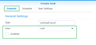

Step 1. Go to "Control Panel > Task Scheduler > Create > Scheduled Task > User defined script"
Step 2.
Step 3.
Step 4.
Click on the schedule you just created then click on Run button.
