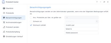

Ja genau das Protokoll-Center.
Ich suche nach einer Lösung um mehr als 3 Felder für die Stichwörter zu bekommen (siehe Anhang).

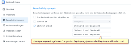

ah jetzt habe ich dich:
Hilft dir das weiter:
/var/packages/LogCenter/target/etc/syslog-ng/patterndb.d/syslog-notification.conf
filter f_synoxfer {
     program("^FtpFileTransfer$")   or
     program("^TFtpFileTransfer$")  or
     program("^FileStation$")       or
     program("^Webdav$")            or
     program("^WinFileService$")    or
     program("^MacFileService$");
filter f_sys_conn_xfer { filter(f_synosys) or filter(f_synoxfer); };
rewrite r_syno_escape_double_quote { subst("\x22", "", value("MESSAGE"), flags("global")); };
rewrite r_syno_escape_backslash { subst("\\\\", "", value("MESSAGE"), flags("global")); };
filter f_syno_keyword_1 { message("Stichwort 1 von 3 Eingabefeld"); };
filter f_syno_keyword_2 { message("Stichwort 2 von 3 Eingabefeld"); };
filter f_syno_keyword_3 { message("Stichwort 3 von 3 Eingabefeld"); };
destination d_syno_keyword_notification_1 {
            pipe("/tmp/syslog_recv.fifo"
                template("{
                    \"hostname\": \"$HOST\",
                    \"command\": \"NTF\",
                    \"ntf_type\": \"keyword\",
                    \"keyword\": \"Stichwort 1 von 3 Eingabefeld\",
                    \"content\": \"$MSGONLY\"
                log_fifo_size(50000)
        persist-name("syno_keyword_notification_1")
destination d_syno_keyword_notification_2 {
                template("{
                    \"keyword\": \"Stichwort 2 von 3 Eingabefeld\",
        persist-name("syno_keyword_notification_2")
destination d_syno_keyword_notification_3 {
                template("{
                    \"keyword\": \"Stichwort 3 von 3 Eingabefeld\",
        persist-name("syno_keyword_notification_3")
log { source(s_syno_syslog); filter(f_syno_keyword_1); filter(f_sys_conn_xfer); rewrite(r_syno_escape_double_quote); rewrite(r_syno_escape_backslash); destination(d_syno_keyword_notification_1); };
log { source(s_syno_syslog); filter(f_syno_keyword_2); filter(f_sys_conn_xfer); rewrite(r_syno_escape_double_quote); rewrite(r_syno_escape_backslash); destination(d_syno_keyword_notification_2); };
log { source(s_syno_syslog); filter(f_syno_keyword_3); filter(f_sys_conn_xfer); rewrite(r_syno_escape_double_quote); rewrite(r_syno_escape_backslash); destination(d_syno_keyword_notification_3); };
Wenn du diese Datei "erweiterst"?
Ich habe in die 3 Zeilen im DSM eingetragen "Stichwort 3 von 3 Eingabefeld" usw um diese Datei zu finden. War nur eine Suchhilfe für mich.
