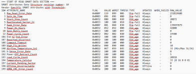

Die Smartwerte habe ich ausgelesen:
Platte 1:
SMART Attributes Data Structure revision number: 10
ID# ATTRIBUTE_NAME FLAG VALUE WORST THRESH TYPE UPDATED WHEN_FAILED RAW_VALUE
1 Raw_Read_Error_Rate 0x000f 117 099 006 Pre-fail Always - 150717592
3 Spin_Up_Time 0x0003 096 095 000 Pre-fail Always - 0
4 Start_Stop_Count 0x0032 081 081 020 Old_age Always - 20249
5 Reallocated_Sector_Ct 0x0033 100 100 010 Pre-fail Always - 0
7 Seek_Error_Rate 0x000f 080 060 030 Pre-fail Always - 116911308
9 Power_On_Hours 0x0032 052 052 000 Old_age Always - 42225
10 Spin_Retry_Count 0x0013 100 100 097 Pre-fail Always - 0
12 Power_Cycle_Count 0x0032 082 082 020 Old_age Always - 18751
184 End-to-End_Error 0x0032 100 100 099 Old_age Always - 0
187 Reported_Uncorrect 0x0032 100 100 000 Old_age Always - 0
188 Command_Timeout 0x0032 100 100 000 Old_age Always - 0
189 High_Fly_Writes 0x003a 068 068 000 Old_age Always - 32
190 Airflow_Temperature_Cel 0x0022 070 061 045 Old_age Always - 30 (Min/Max 29/33)
191 G-Sense_Error_Rate 0x0032 100 100 000 Old_age Always - 0
192 Power-Off_Retract_Count 0x0032 100 100 000 Old_age Always - 15
193 Load_Cycle_Count 0x0032 090 090 000 Old_age Always - 20295
194 Temperature_Celsius 0x0022 030 040 000 Old_age Always - 30 (0 15 0 0 0)
197 Current_Pending_Sector 0x0012 100 100 000 Old_age Always - 0
198 Offline_Uncorrectable 0x0010 100 100 000 Old_age Offline - 0
199 UDMA_CRC_Error_Count 0x003e 200 200 000 Old_age Always - 0

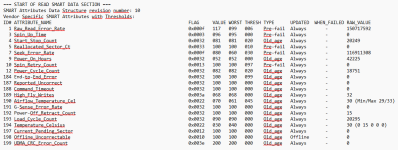

Platte 2:
1 Raw_Read_Error_Rate 0x000f 119 099 006 Pre-fail Always - 232819600
3 Spin_Up_Time 0x0003 096 096 000 Pre-fail Always - 0
4 Start_Stop_Count 0x0032 080 080 020 Old_age Always - 20872
7 Seek_Error_Rate 0x000f 081 060 030 Pre-fail Always - 139697879
9 Power_On_Hours 0x0032 052 052 000 Old_age Always - 42800
12 Power_Cycle_Count 0x0032 082 082 020 Old_age Always - 19300
189 High_Fly_Writes 0x003a 090 090 000 Old_age Always - 10
190 Airflow_Temperature_Cel 0x0022 067 059 045 Old_age Always - 33 (Min/Max 31/36)
192 Power-Off_Retract_Count 0x0032 100 100 000 Old_age Always - 5
193 Load_Cycle_Count 0x0032 090 090 000 Old_age Always - 20918
194 Temperature_Celsius 0x0022 033 041 000 Old_age Always - 33 (0 16 0 0 0)

Die HDDs schauen meines erachten gut aus.

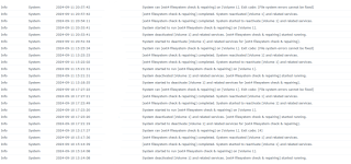

So, nun mal ein paar Logs:
Grüße Kanzler

Dein Dateisystem ext4 des Volume ist tot, kannst du nur löschen und neu erstellen.

Ja, Backups habe ich. Aber ich kann ganz normal auf die Daten zugreifen, geht das auch mit einem gestorbenen Dateisystem?
13.346
5.602
524
Aber nicht mehr speichern/schreiben oder?
Kanzler27
11. Sep 2024
Doch, doch, das geht alles.
Es gibt die Warnung im DSM, das dass Volume 1 gelitten hat und ich kann es nicht reparieren. Komisch.
13.346
5.602
524
Ticket bei Synology aufmachen?
