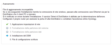

Ricyx
26. Jun 2023
17
hello to all the forum, I have a ds110 like yours and I've been trying to install the dsm of the 112j on a new hard disk for 2 days (therefore starting from 0).
I followed the user guide by changing the filename from 112j to 110j, the installation starts but says incompatible.
then I tried to open the .pat file with 7zip and on VERSION file I modified with hexadecimal editor changing from 112 to 110 on the UNIQUE item. save but Synology Assistant tells me "file corrupted"
I also tried to open the .pat file with the hexadecimal editor and change the name unique 112 --> 110 but it also tells me corrupted file
I don't understand where am I wrong!?
Maybe someone can maybe make a video to help me on how to do it so I can replicate it? or post .pat file already edited for compare
I state that I do not have access with putty because it refuses me the ssh connection, if I telnet instead it asks me for a login and password but ADMIN always gives me incorrect login

Ricyx
26. Jun 2023
17
my problem was that i had no way to access via ssh because there was no system installed in the diskstation, now i managed to recover the old 5.2 software via archive.org (bless that site)
To whom it may be useful, here is the link: DSM 5.2
now i just finished update 9 and i see if i can modify the file you told me

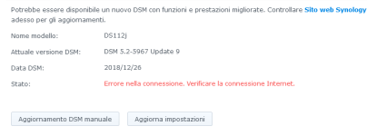

Ricyx
26. Jun 2023
17
This file has to be modified on the Diskstation, not in the setup archive. Therefore, you have to login via ssh
ok now i've edit synoinfo file i try to update with a modded .pat but return back error INCOMPATIBLE UPDATE
i've restart and Synology Assistant ask to me to reinstall OS, i've tried to get 112j .pat called 110j.pat but always incompatible update
what can i do?!
sorry for the disturb
14.437
5.045
544
But the .pat file shouldn't be modified. Or am I wrong?
Sorry, I have never done these steps for myself so I can only assist you a little bit.
I think you have to do these steps:
-modify the /etc.defaults/synoinfo.conf file in the described way
-Restart the NAS (or modify the /etc/synoinfo.conf in the same way, but normally restarting the NAS will do that for you)
-after the restart, the NAS should show up "DS112j" as model in the control panel
-install the non modified (correct me, if you have other information) update (.pat file)
-if the NAS is denying the update, just do a reset via UI in the control panel and install newest version with Synology Assistant
