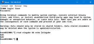

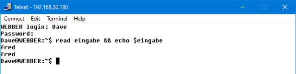

telnetd in DSM 7.2.2 is the same version as DSM 6.2.4
~# telnetd --version
telnetd (GNU inetutils) 1.9.4
and read eingabe && echo $eingabe works for me in both DS 7.2.2 and DSM 6.2.4
DSM 6.2.4
DSM 7.2.2

@DaveR, which telnet-client did you use?
It's Microsoft's telnet.exe from Windows 2000. I kept a copy when I discovered it was much better than the telnet.exe in WinXP and have used it in every Windows version since then.
