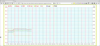

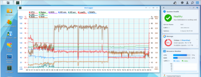

The code now works OK but the graph is still opened in a separate tab, not a Synology Desktop inline window as for DSM6. I expected that the window will be like that in the picture (1) attached. But AvrLogger opens his own browser tab and displays his charts alone, see picture (2) attached.

The separet Browser Tab for AVRLogger Chart is normal in DSM 7.x
Reaktionen: ded
ded
09. Aug 2024
Thank you Benie for the information. Oh, yet another tab in the browser... sounds not so good. Anyway AvrLogger greatly helps me in monitoring tasks. Many thanks BigRonin for the app.
