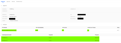

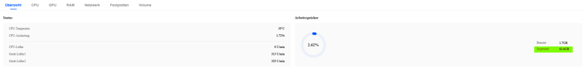

Vielleicht kannst Du mal die Ausstattung mit Speicher, RAM, OS ein bisschen zeigen.
# dmidecode 3.4
Getting SMBIOS data from sysfs.
SMBIOS 3.6.0 present.
# SMBIOS implementations newer than version 3.5.0 are not
# fully supported by this version of dmidecode.
Handle 0x0028, DMI type 17, 92 bytes
Memory Device
        Array Handle: 0x0027
        Error Information Handle: Not Provided
        Total Width: 64 bits
        Data Width: 64 bits
        Form Factor: SODIMM
        Set: None
        Locator: Controller0-ChannelA-DIMM0
        Bank Locator: BANK 0
        Type: DDR5
        Type Detail: Synchronous
        Speed: 5600 MT/s
        Manufacturer: Kingston
        Serial Number: xxxxxxxxxxxx
        Asset Tag: 9876543210
        Part Number: KF556S40-32
        Rank: 2
        Configured Memory Speed: 4800 MT/s
        Minimum Voltage: 1.1 V
        Maximum Voltage: 1.1 V
        Configured Voltage: 1.1 V
        Memory Technology: DRAM
        Memory Operating Mode Capability: Volatile memory
        Firmware Version: Not Specified
        Module Manufacturer ID: Bank 2, Hex 0x98
        Module Product ID: Unknown
        Memory Subsystem Controller Manufacturer ID: Unknown
        Memory Subsystem Controller Product ID: Unknown
        Non-Volatile Size: None
        Volatile Size: 32 GB
        Cache Size: None
        Logical Size: None
Handle 0x0029, DMI type 17, 92 bytes
Memory Device
        Data Width: 64 bits
        Form Factor: SODIMM
        Set: None
        Locator: Controller1-ChannelA-DIMM0
        Type: DDR5
        Speed: 5600 MT/s
        Serial Number: xxxxxxxxxxxxxxx
        Rank: 2
        Cache Size: None
        Logical Size: None
